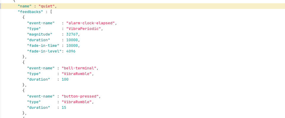

PureOS includes a feedback theme that describes how the Librem 5 should vibrate for certain events.  (The same theme also controls LED lights and sounds, since they are also forms of feedback.)  The theme can specify how long to turn on the motor, the strength to apply, and other factors like periodic vibrations and fade-in.
Screenshot of JSON theme data from the linked feedback theme
Alarms fade in and keep pulsing until the alarm is dismissed, while a key press produces a brief one-time vibration.
Most of those parameters didn’t really work correctly on Byzantium.  While we could tune the feedback a bit, the pulses were too long and too strong.  Keyboard pulses would blend together for fast typing, and sometimes it would stop activating the motor entirely.

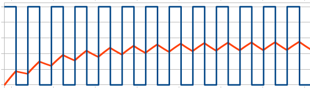

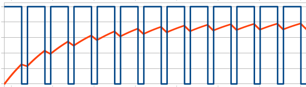

To produce the subtle vibrations from our theme, the Linux kernel uses pulse-width modulation, or PWM.  It quickly changes the on/off signal to approximate any level in between “off” and “on”.
The motor takes a little bit of time to physically start or stop spinning.  As long as we modulate the on/off signal more quickly than the motor can start or stop spinning, we can produce a strength in between.
With the motor on 50% of the time, we can approximate half intensity:
With 75% duty, we can produce a higher intensity:

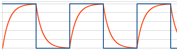

The PWM rate was the problem: it was set to just 1 Hz, or one change per second.  The motor spins up and down much more quickly than that, so this didn’t really work.  You couldn’t produce a pulse of 0.1 seconds at 50% strength – you’d get either 0.1 seconds of 100% strength if the PWM ended up ‘on’, or you might end up with 0.1 seconds of 0% strength if enough earlier pulses blended together to reach an ‘off’ modulation.
Since the modulation frequency is too low, 50% duty doesn’t produce 50% intensity any more.  Instead, you get 1-second pulses.  If the vibration is less than 1 second, you just get a 100% strength pulse.  The modulation didn’t do anything in that case.

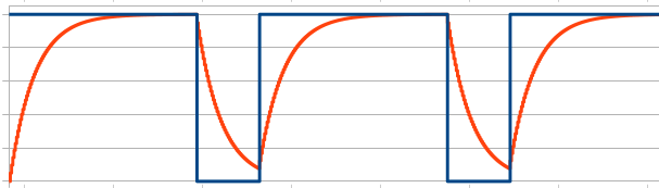

The modulation still doesn’t really do anything at 75% duty other than change the length of the pulses.
